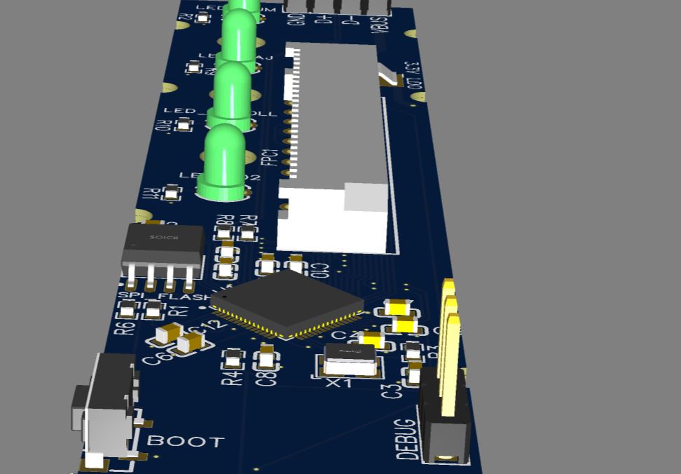

RP2040 PCB for TypeMatrix keyboard, to substitute to the default PCB. Usage: upgrade TypeMatrix to QMK firmware.
Should fit into the typematrix without any change, unless:
- 2 holes to perform on the left side of the TypeMatrix black box (to access to BOOT and RESET buttons)
- unsolder / resolder the USB cable - be aware of the D- / D+ cable side
- update some item ref (as resistors), to pick availeble refs at JLCPCB for direct soldering
- in QMK, design the right keyboard matrix (not done yet), to affect GPIO0 to 25 to the right row/col.
TO BE VERIFIED, not yet tested.
