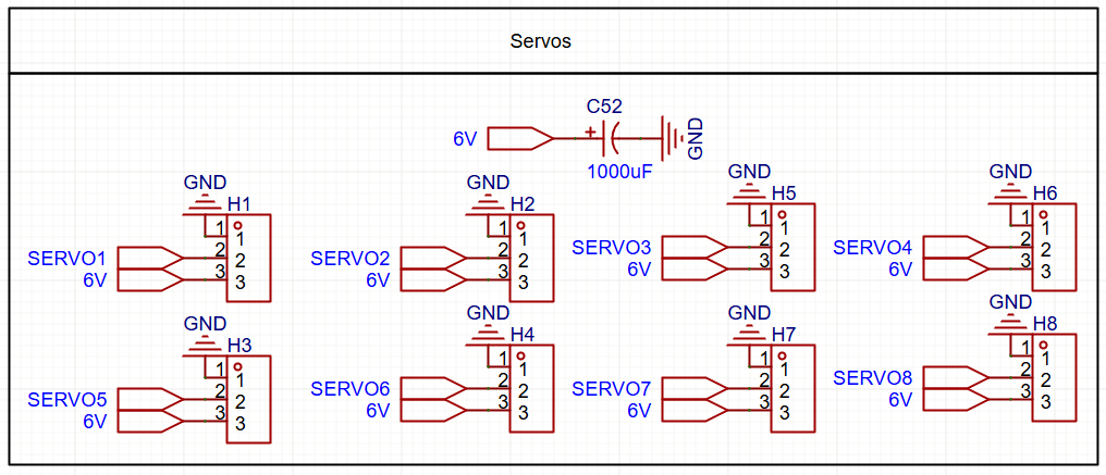

A key architectural decision is how servos are handled. Servo PWM generation is moved off the MCU and onto a PCA9685 PWM driver (16 channels, with 8 intended for the canards and headroom for expansion). This avoids servo timing jitter caused by CPU load, logging spikes, or other real-time tasks. It also keeps the control loop “pure”: the MCU computes the desired angles, and the PWM chip handles the actual pulse generation.

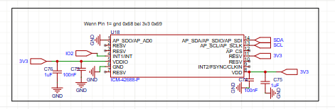

This block is the ICM-42688-P 6-axis IMU (3-axis gyroscope + 3-axis accelerometer) on the PROTON-3 flight computer. It’s connected via I²C (SDA/SCL) and provides the high-rate motion data the firmware needs for attitude estimation, stability control, and clean flight logging.
The AD0/address strap lets the same sensor coexist with other devices on the bus (0x68 when Pin 1 = GND, 0x69 when Pin 1 = 3V3). The INT pins are routed so the MCU can timestamp samples precisely and reduce jitter, which matters for reliable control loops. The local 1 µF + 100 nF decoupling on the supply rails keeps the sensor stable under fast current spikes and high-vibration conditions typical for model rockets.

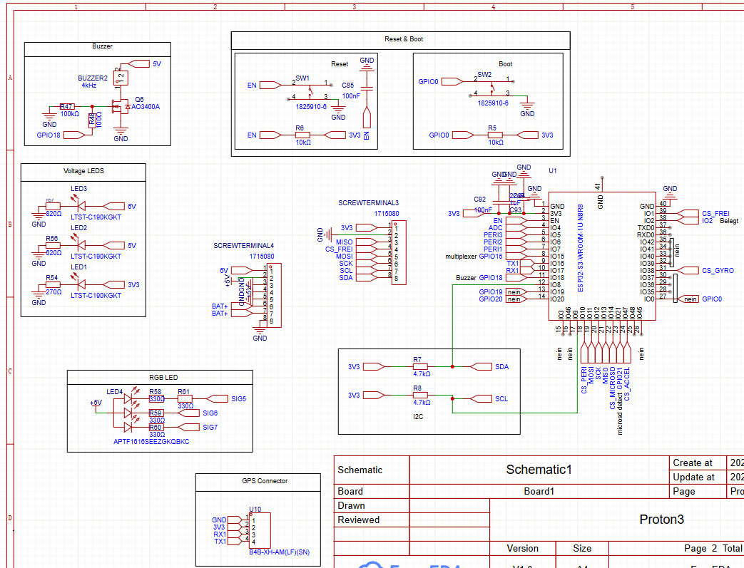

This page is the “processor + user interface + external I/O” section of the PROTON-3 flight computer.
  • ESP32-S3-WROOM-1U (U1): The main MCU that runs the flight state machine, sensor acquisition, logging, and telemetry. All key buses and control nets are broken out cleanly for reliable routing and debugging.
  • Reset & Boot circuitry: Two tactile switches implement the standard ESP32 workflow:
    • EN/Reset (SW1) with a small 100 nF capacitor for clean reset behavior and a 10 kΩ pull-up to 3V3.
    • BOOT (SW2 / GPIO0) with a 10 kΩ pull-up so the board boots normally, but can be forced into the ROM bootloader for flashing/recovery.
      This makes firmware bring-up and field recovery painless.
  • Buzzer driver: A small 4 kHz buzzer is switched via an AO3400A MOSFET from a GPIO. This gives loud, unmissable audible feedback for arming states, errors, continuity checks, or recovery events—useful when you can’t stare at a screen on a launch site.
  • Power-rail indicator LEDs (3V3 / 5V / 6V): Three simple LEDs show which rails are present. That sounds basic, but it saves real time when diagnosing power issues in the field or after a hard landing.
  • RGB status LED: A multi-channel LED driven through series resistors provides an immediate “system health / mode” indicator (safe, armed, logging, error, etc.) without needing a serial console.
  • I²C pull-ups: 4.7 kΩ pull-ups on SDA/SCL ensure the bus behaves predictably even with mixed sensor modules and cable lengths—important for stable IMU/baro operation and clean timestamps.
  • GPS connector: A dedicated 4-pin connector (GND, 3V3, RX, TX) for an external GPS module keeps integration simple and mechanically robust.
  • External screw-terminal breakouts: Power and bus lines are brought to screw terminals for easy bench testing, modular expansion, and quick swapping of external modules (SPI/I²C devices, auxiliary sensors, test harnesses) without reworking the PCB.
Overall, this sheet is about making the flight computer easy to flash, easy to debug, and easy to operate at the pad—with clear status feedback, robust bus wiring, and straightforward expansion points.

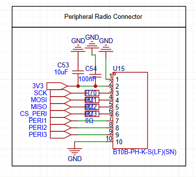

This block is the Peripheral Radio Connector: a dedicated 10-pin header that lets PROTON-3 plug into an external RF/telemetry module without baking a specific radio into the main PCB.
It exposes a clean SPI interface (SCK/MOSI/MISO + CS) plus several PERI GPIO lines for IRQ, reset, enable, or module-specific handshakes. Power is provided as 3V3 and GND, with local bulk + high-frequency decoupling (10 µF + 100 nF) right at the connector to keep the radio supply stable during TX current bursts. The small series resistors on the signal lines help reduce ringing/EMI and make the link more robust with real wiring and connectors.
Net result: a modular, swappable telemetry port that supports different radios (LoRa, FSK, custom links) while keeping signal integrity and power stability under control.This block is the Peripheral Radio Connector: a dedicated 10-pin header that lets PROTON-3 plug into an external RF/telemetry module without baking a specific radio into the main PCB.

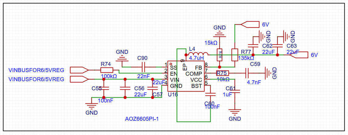

This block is the 6 V power stage, built around the AOZ6605PI-1 synchronous buck regulator. It takes the upstream supply rail (battery/USB-derived system input) and generates a clean, efficient 6 V bus for high-current peripherals like servos and actuators, keeping those noisy loads off the sensitive 3.3 V logic domain.
Key design points:
  • 4.7 µH inductor (L4) and low-ESR output capacitors (22 µF + 22 µF) provide low ripple and good transient response when a servo suddenly loads/unloads.
  • Feedback divider sets the output voltage precisely to 6 V.
  • COMP/compensation network stabilizes the control loop so the regulator doesn’t oscillate with real-world wiring and pulsed loads.
  • Bootstrap cap + local decoupling are placed close to the IC to support fast switching edges and reduce EMI.
  • Input filtering and bulk caps help absorb input spikes so the rest of the system remains stable during high dynamic current events.
Net result: a robust 6 V rail that’s efficient, tolerant to aggressive load steps, and designed for the kind of current pulses you get in flight-control hardware.

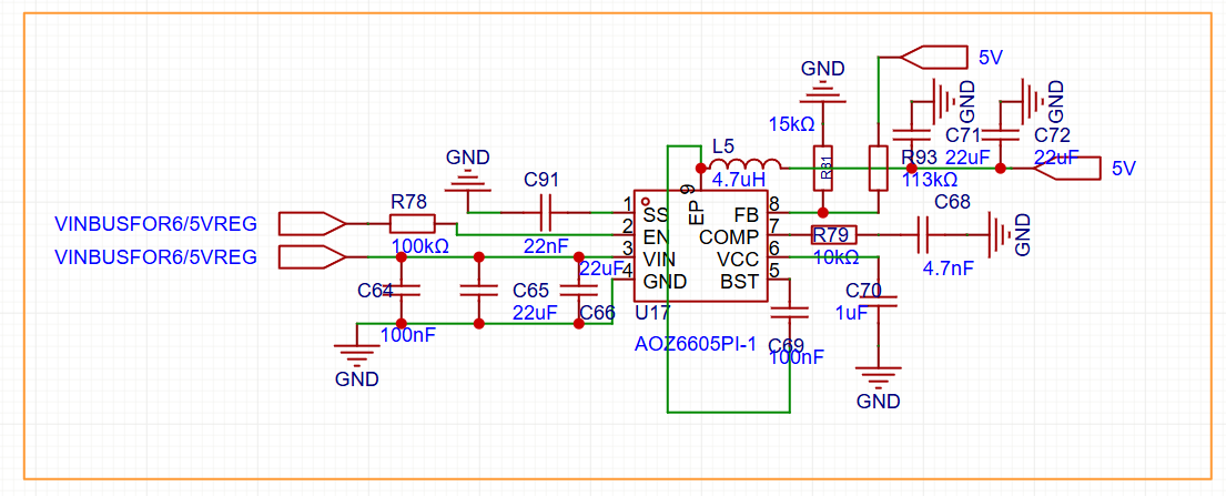

This block is the 5 V power stage, again using the AOZ6605PI-1 synchronous buck regulator. It generates the board’s 5 V bus from the upstream system input (battery/USB-side rail), providing an efficient intermediate rail for peripherals and downstream regulators.
Why it’s there:
  • A dedicated 5 V rail is a practical “workhorse” supply for external modules, expansion connectors, and any 5 V-rated subsystems, while keeping switching noise and load spikes away from the 3.3 V logic domain.
  • It also gives you a stable source for any secondary regulation (e.g., clean 3.3 V generation) without relying on USB quality.
Design highlights:
  • 4.7 µH inductor (L5) plus bulk/ceramic output capacitors (22 µF + 22 µF) to handle fast load steps with low ripple.
  • Feedback divider programs the output to exactly 5 V.
  • The COMP network sets loop stability, so the converter stays well-behaved with real wiring, mixed loads, and high dI/dt events.
  • Proper bootstrap + local decoupling close to the IC improves switching performance and reduces EMI.
Net result: a clean, efficient, and robust 5 V rail that supports the “messy” external world while protecting the flight-critical 3.3 V domain.

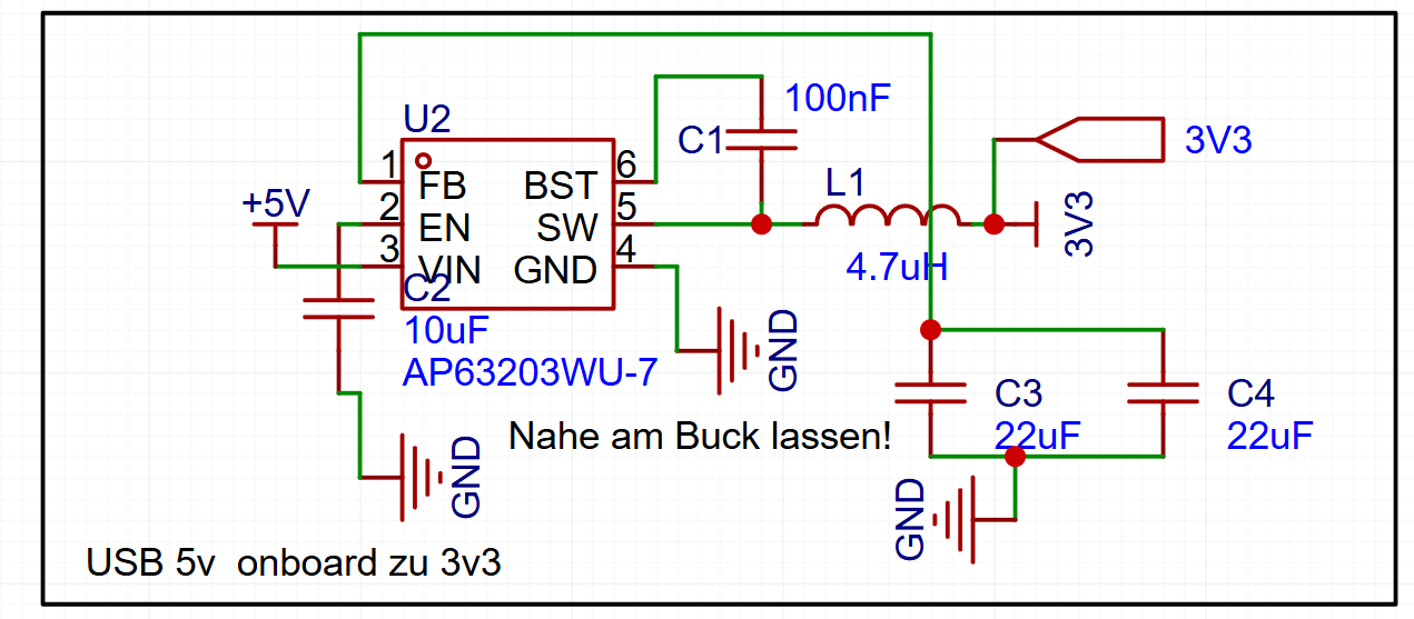

This block is the onboard 5 V → 3.3 V step-down supply for the flight computer logic, built around an AP63203WU-7 synchronous buck regulator. It converts the available 5 V rail (USB or the internal 5 V bus) into a stable 3V3 domain for the ESP32-S3 and all sensors.
Why it’s used:
  • A switching buck is far more efficient than an LDO when dropping from 5 V to 3.3 V, which reduces heat and keeps the board reliable in a closed airframe.
  • It provides a stiff, low-impedance 3.3 V rail that tolerates the ESP32’s Wi-Fi/CPU current bursts and high-rate sensor sampling without brownouts.
Design highlights:
  • 4.7 µH inductor and 22 µF + 22 µF output capacitance to handle load steps and keep ripple low.
  • Input bulk capacitor (10 µF) and high-frequency decoupling (100 nF) placed close to the IC to keep switching noise under control.
  • Simple, robust reference/feedback wiring for predictable startup and regulation behavior.
Net result: a cool-running, dependable 3.3 V supply that keeps the flight stack stable even when the system is logging hard or transmitting telemetry.

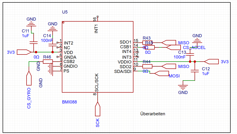

This block is the BMI088 IMU: a high-performance 3-axis accelerometer + 3-axis gyroscope used as the flight computer’s primary “hard” motion sensor. In a rocket, you want an IMU that stays stable under high vibration and high acceleration, and the BMI088 is built for exactly that kind of environment.
What you see here:
  • SPI interface (SCK/MOSI/MISO + chip-selects) for fast, deterministic sampling and clean timing compared to a slow, shared bus.
  • Separate CS lines for gyro and accel (typical for BMI088), so each part can be configured and read independently at high rate.
  • INT lines routed to the MCU for precise data-ready interrupts and consistent timestamping—critical for control loops and for correlating IMU data with baro/GPS logs.
  • Local decoupling (1 µF + 100 nF on the supply rails) placed close to the IC to keep the sensor quiet when the MCU and radio create transient current spikes.
  • Small series resistors on SPI lines to tame edge ringing and reduce EMI/crosstalk, which matters with high-speed digital lines running near sensitive analog sensing.
Net result: a robust, high-rate inertial sensing block that supports reliable attitude estimation and flight control even when the airframe is shaking and the dynamics get violent.

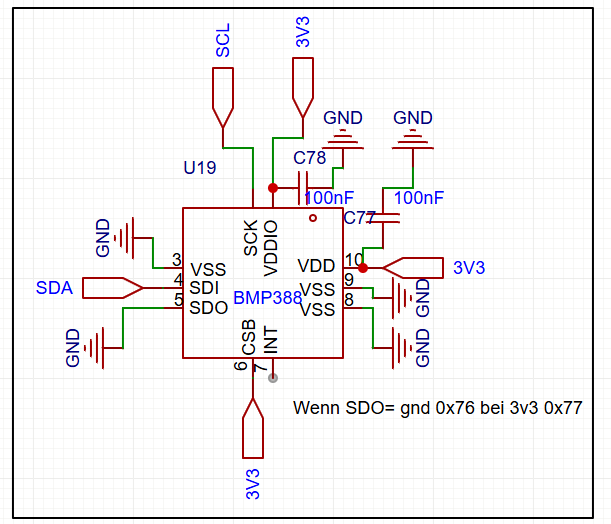

This block is the BMP388 barometric pressure sensor, used for altitude measurement and apogee detection. Baro altitude is still one of the most reliable signals for flight events (liftoff, coast, apogee, descent), especially when GPS is noisy or has low update rate.
What’s implemented here:
  • I²C connection (SDA/SCL) for simple integration alongside other sensors.
  • The SDO/address strap selects the I²C address (0x76 when SDO = GND, 0x77 when SDO = 3V3), which avoids conflicts on the shared bus.
  • Local decoupling capacitors (100 nF) close to the supply pins to keep the sensor stable and reduce noise that would show up as altitude jitter.
  • The CSB pin is set for I²C mode, and the INT pin is available for data-ready/interrupt-driven sampling if needed.
Net result: a clean, high-resolution altitude source that complements the IMU and enables robust flight-state decisions and reliable recovery triggering.

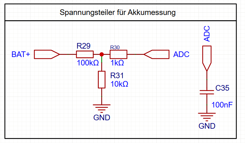

This block is the battery voltage measurement divider. It scales the raw BAT+ voltage down to a safe range for the MCU’s ADC, so the flight computer can continuously monitor battery state during arming, flight, and recovery.
  • R29 (100 kΩ) + R31 (10 kΩ) form the divider (≈ 11:1), so the ADC sees roughly one eleventh of the pack voltage.
  • R30 (1 kΩ) is a small series resistor that protects the ADC pin and, together with C35 (100 nF), forms a low-pass filter. That reduces switching noise and servo/transmitter spikes that would otherwise show up as jitter in the reading.
Net result: a low-current, robust voltage sense that enables brownout prevention, flight logging of battery behavior, and clean pre-flight “battery OK” checks.

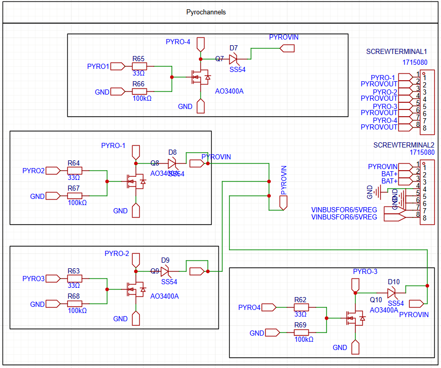

This page implements the pyro / deployment output stage: four independent high-current channels intended for recovery events (e.g., igniters for ejection charges, cutters, separation devices), routed to robust screw terminals for field wiring.
Each channel uses an AO3400A N-MOSFET as a low-side switch, so the flight computer can fire a load reliably while keeping the control electronics isolated from the high-current path. The 33 Ω gate resistors tame switching edges (less EMI, cleaner behavior), and the 100 kΩ gate pull-downs make the default state fail-safe: if the MCU is unpowered, reset, or a pin floats, the MOSFET stays hard OFF. The SS54 Schottky diodes add extra protection/isolation against reverse or parasitic current paths and help prevent one channel or external wiring from feeding back into the pyro supply rail.
Net result: a modular, serviceable, safety-oriented deployment interface with clear channel separation, robust connectors, and protective details that matter in real launch conditions.

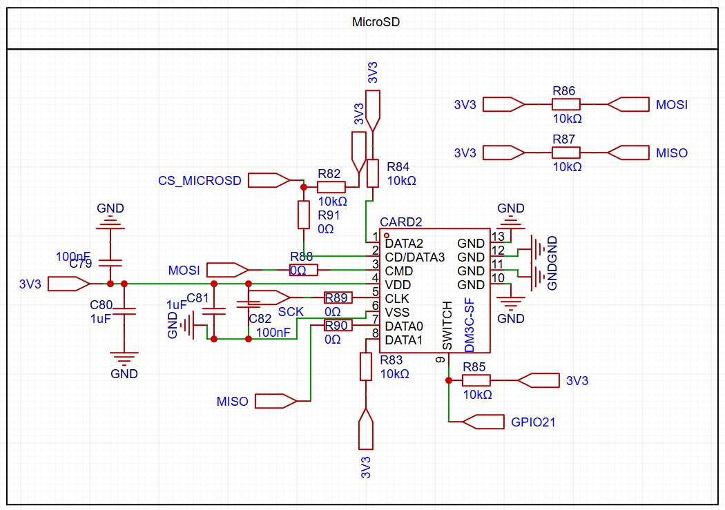

This block is the microSD logging interface, which is a core part of PROTON-3: it enables high-rate flight data recording directly on the vehicle, independent of radio link quality.
What’s going on here:
  • The socket is wired in SPI mode (CS, SCK, MOSI, MISO) for simple, reliable integration with the ESP32.
  • 0 Ω series links on the SPI lines are used as “configuration jumpers” / debug options: they let you add damping resistors later if signal integrity ever becomes an issue, without redesigning the PCB.
  • The 10 kΩ pull-ups on the data/command lines provide defined logic levels during reset and power-up so the card doesn’t boot into weird states.
  • A dedicated card-detect switch is routed to a GPIO (with a pull-up), so firmware can detect insertion/removal and handle logging safely.
  • Local decoupling (1 µF + 100 nF) near the socket helps absorb the SD card’s short current spikes during write bursts, improving stability and reducing brownout risk.
Net result: a robust SD subsystem designed for real-world flight logging—clean startup behavior, debuggable SPI routing, and power integrity measures that protect data capture under vibration and supply transients.

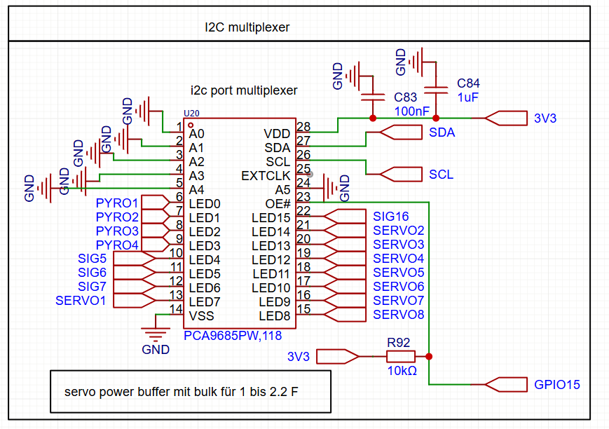

This block is the PCA9685 16-channel PWM driver (often mistaken for an I²C multiplexer, but it’s actually a PWM expander). It’s used to generate clean, hardware-timed servo pulses without tying up the ESP32’s timers or adding jitter when the MCU is busy logging sensors or handling telemetry.
What it does in PROTON-3:
  • Drives up to 16 PWM outputs (here used for SERVO1…SERVO8 plus extra signals), ideal for canards/TVC servos, release servos, or other actuators.
  • Runs over I²C (SDA/SCL), so the control interface stays simple while the timing is handled by dedicated hardware.
  • Provides a stable output update behavior even under CPU load — important when you want repeatable control response in flight.
Design details visible here:
  • Local decoupling (100 nF + 1 µF) on the PCA9685 supply to keep it stable during switching edges on many channels.
  • Address pins A0–A5 are broken out/strapped so multiple PCA9685s could coexist if you ever expand.
  • OE (Output Enable) is routed (with a pull-up/down strategy) so you can globally disable all servo outputs as a safety feature (e.g., SAFE mode / disarmed state).
  • Notes about bulk capacitance on the servo power rail: servos cause nasty current spikes, so the design anticipates local buffering close to the actuator supply.
Net result: a low-jitter, scalable actuator control layer that makes PROTON-3’s control surfaces behave consistently, even while the ESP32 is doing high-rate sensor acquisition and SD logging.

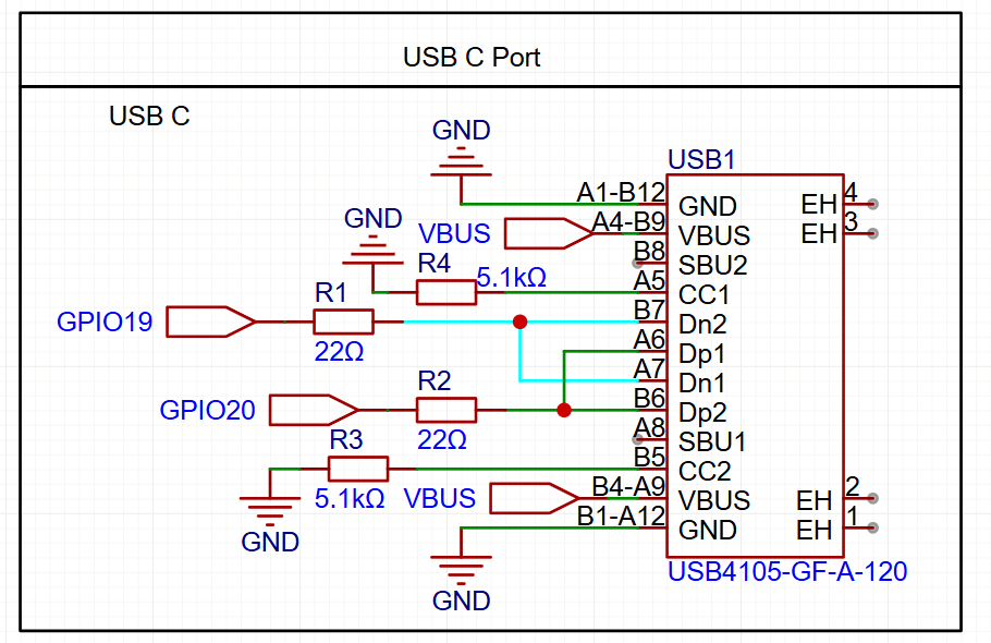

This block is the USB-C interface used for power and direct wired data access (flashing, debugging, log download) on the PROTON-3 flight computer.
  • USB-C receptacle (USB1) with VBUS and GND brought onto the board for the 5 V supply path.

This block is the servo power + output harness for PROTON-3. It breaks out eight servo channels (SERVO1…SERVO8) to standard 3-pin headers, each carrying PWM signal + 6 V + GND, so actuators can be plugged in directly with no adapter wiring.
A large 1000 µF bulk capacitor sits on the 6 V rail near the headers. Servos draw sharp current spikes when they start, stall, or get hit by aerodynamic loads; the bulk cap buffers those peaks, reduces rail dip, and prevents the rest of the flight computer from seeing brownouts or noisy resets.
Net result: a field-friendly, high-current servo interface designed for real control surfaces—stable power delivery, clean wiring, and scalable channel count for canards, TVC, and recovery mechanisms.
