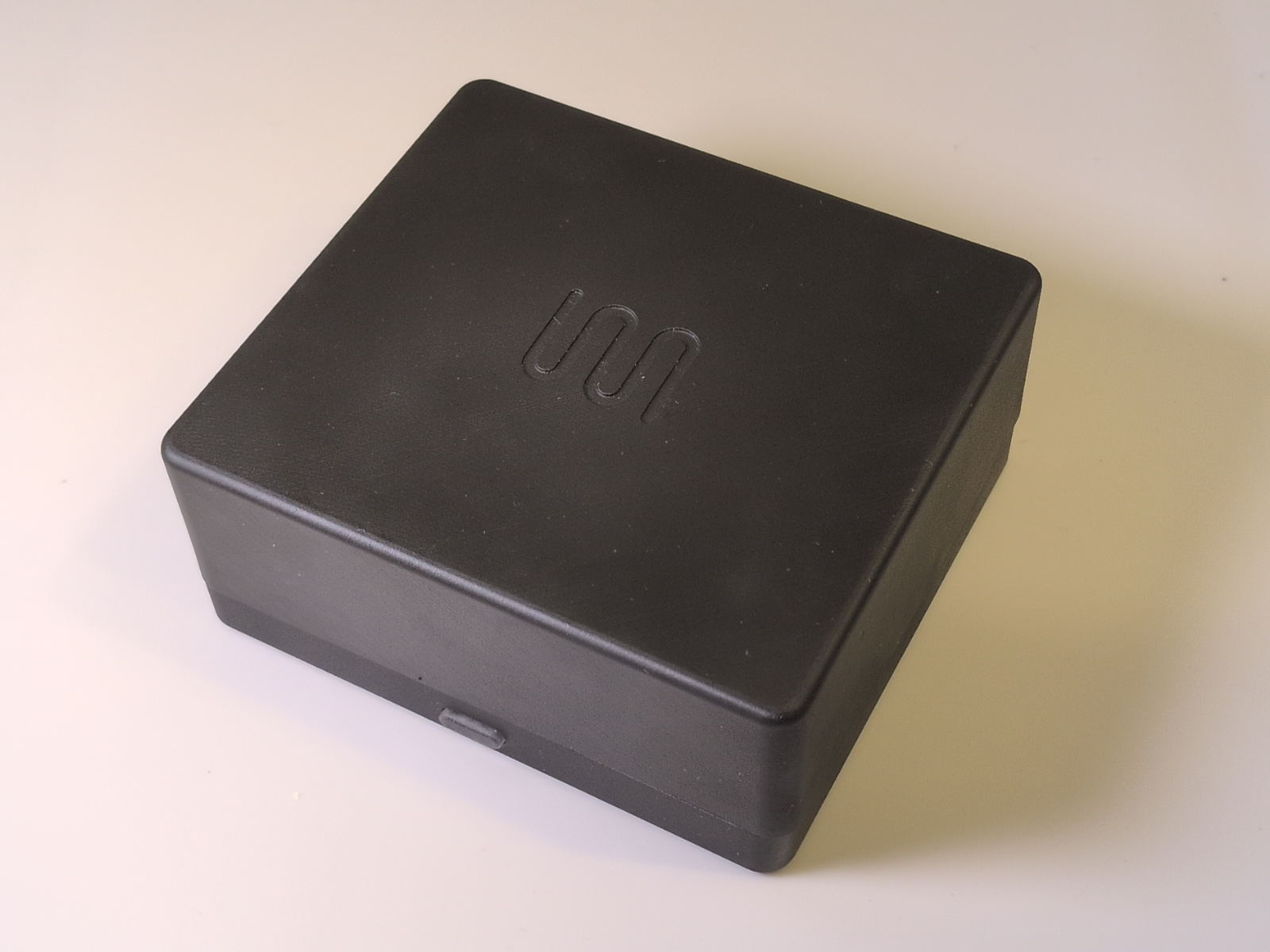

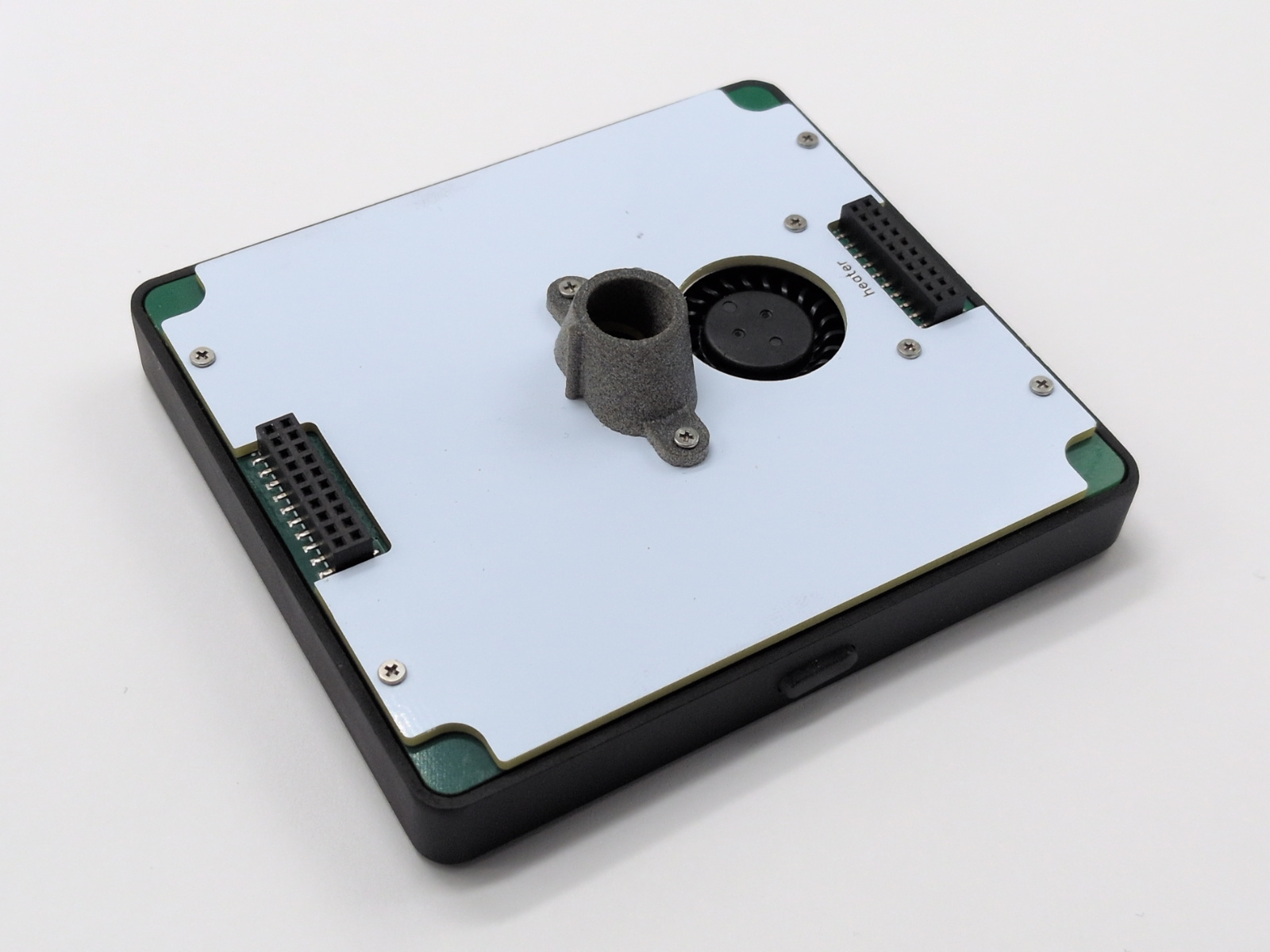

Reflow Micro Table is a compact Bluetooth-controlled reflow table with an 80×70 mm working area. It is built for those who assemble PCBs from time to time and do not want a bulky professional-grade machine taking up desk space.
It runs from a 100–140 W USB PD charger, is controlled via a web browser on desktop or mobile, and closes into a compact case for storage when the job is done.

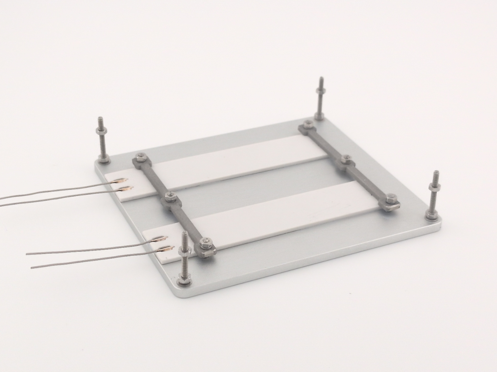

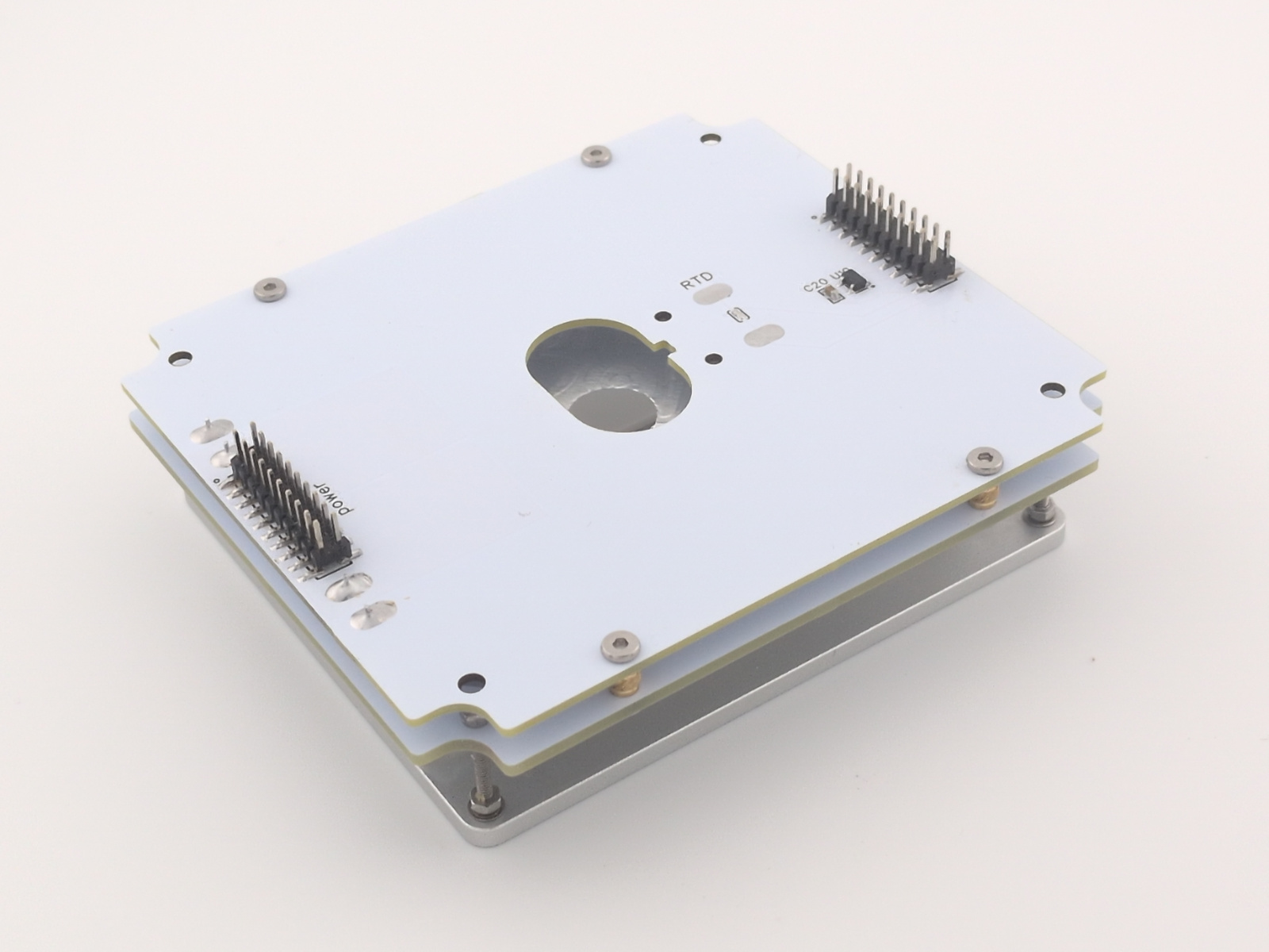

The MCPCB-based head reaches up to 180°C. The MCH-based head reaches up to 250°C. Component cost is about $85 with the MCPCB heater and about $105 with the MCH heater.

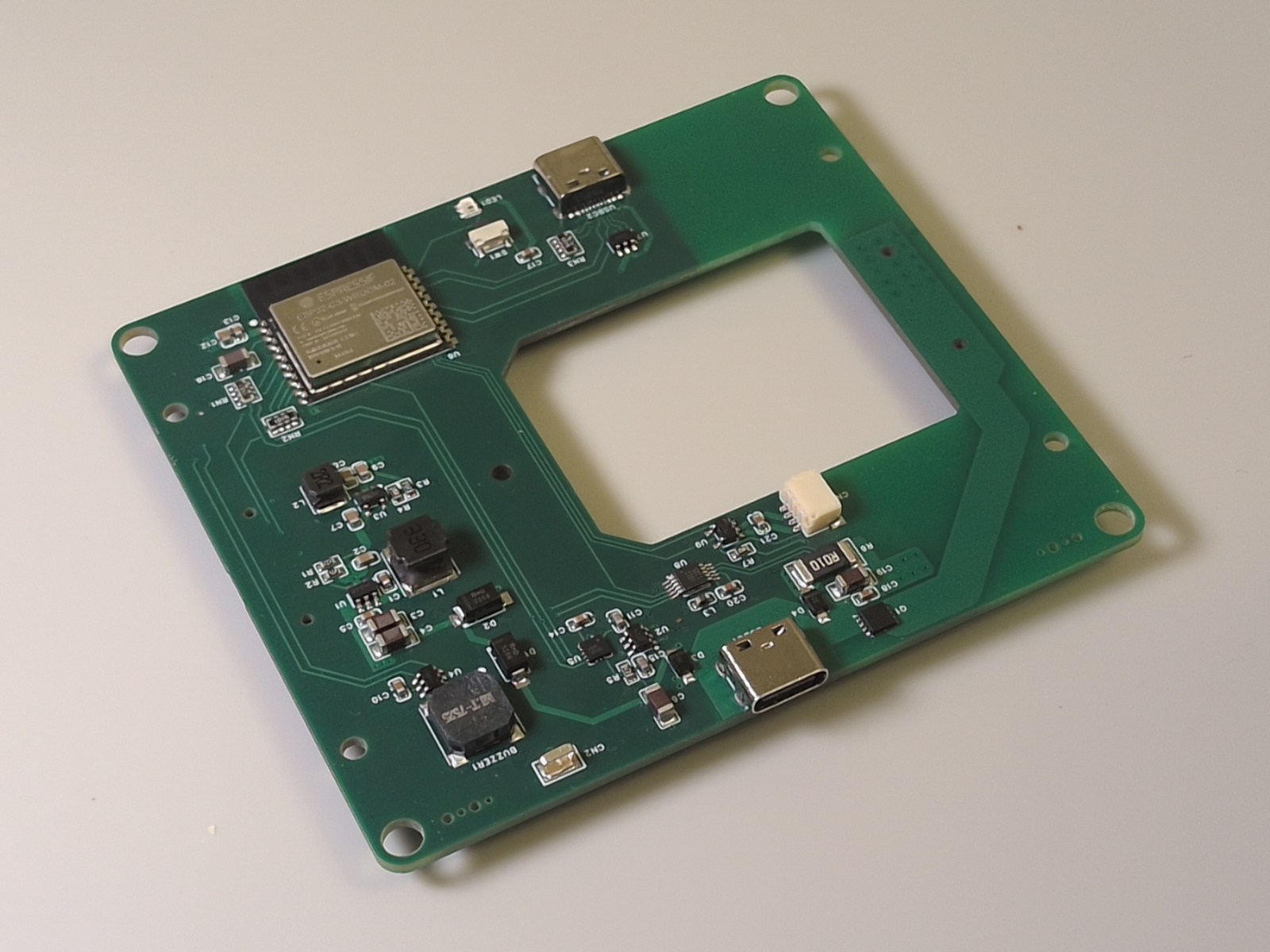

  • 140 W USB PD chargers were chosen as the power source. They are widely available, and single-port models cost as little as $25.
  • Since there was no good open-source USB PD support available, a separate project was created: pdsink.
  • Dynamic PD profile switching was implemented: a cold heater has too low resistance to immediately apply maximum voltage safely.
The table prefers a PPS profile with voltage regulation. If the required voltage cannot be reached via PPS, it goes up to Fixed 28 V with PWM. Once PD 3.2 chargers with mandatory AVS profile support arrive — expected by the end of 2026 — PWM will no longer be needed.

Rather than a separate temperature sensor, the table calculates temperature from the heater's own TCR (temperature coefficient of resistance). This significantly simplifies both the hardware and the case — an important factor for a DIY build. After two-point calibration, accuracy is within a few degrees.

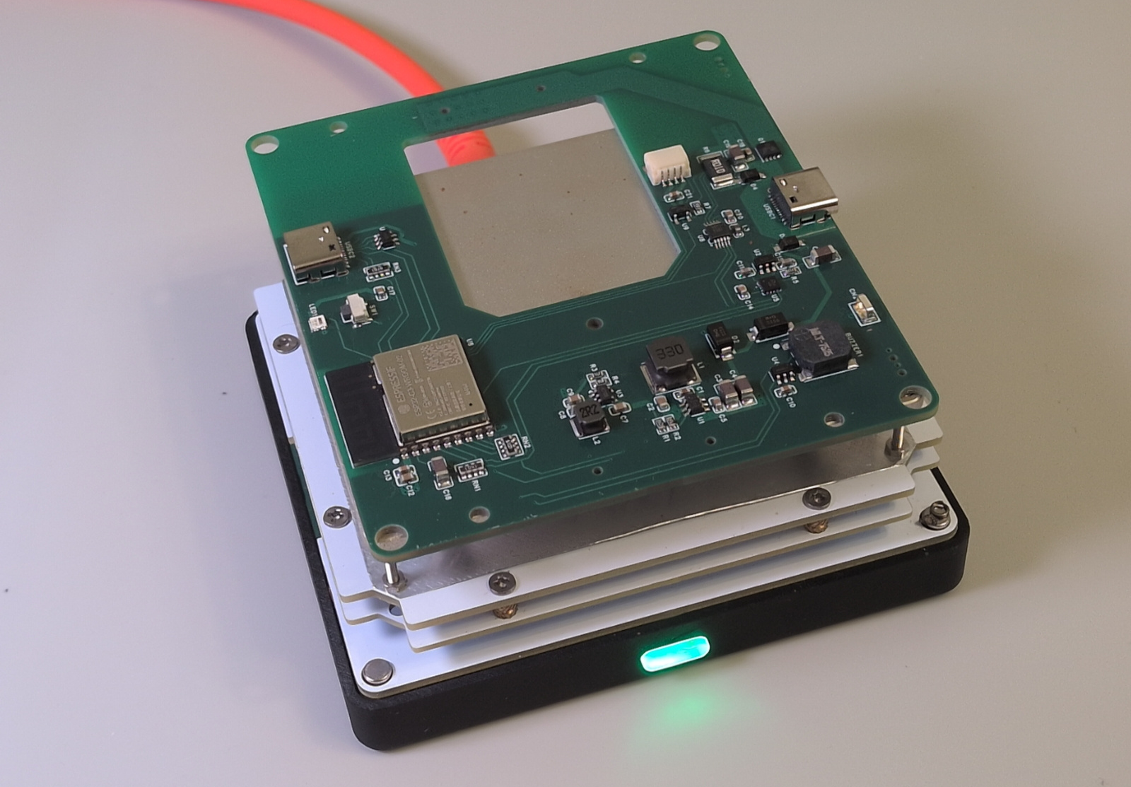

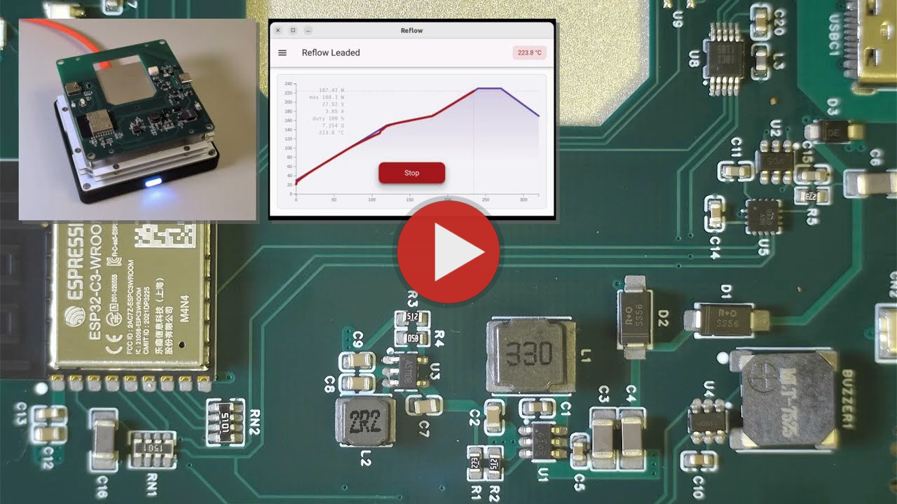

I have no production PCB assembly experience, so the profiles were developed from whatever information I could find. Fortunately, staying away from RoHS paste gives a comfortable margin for error. Due to limited power headroom at this plate size, the leaded profile had to be stretched, though the goal was to stay within the JEDEC limit of 60 seconds in the liquid phase.
One thing to keep in mind with bottom heating: the temperature difference between the heater and the top surface of the board is around 20°C. Heavy boards with internal copper layers can lag noticeably during ramp-up. As visible in the video, the table handles even this worst case successfully.

Browser Control
Browser-based control might seem like overengineering, but in practice, it adds no friction and simplifies everything else. The web app is a PWA: it works offline and can be installed as a regular app on any device.
This allowed the device itself to have a single button, which simplified both the circuit and the case. If you only use one profile, the button alone is enough to start a run — no app required.
One known limitation: iOS does not expose Web Bluetooth to the browser. A Wi-Fi fallback is a possible future improvement.

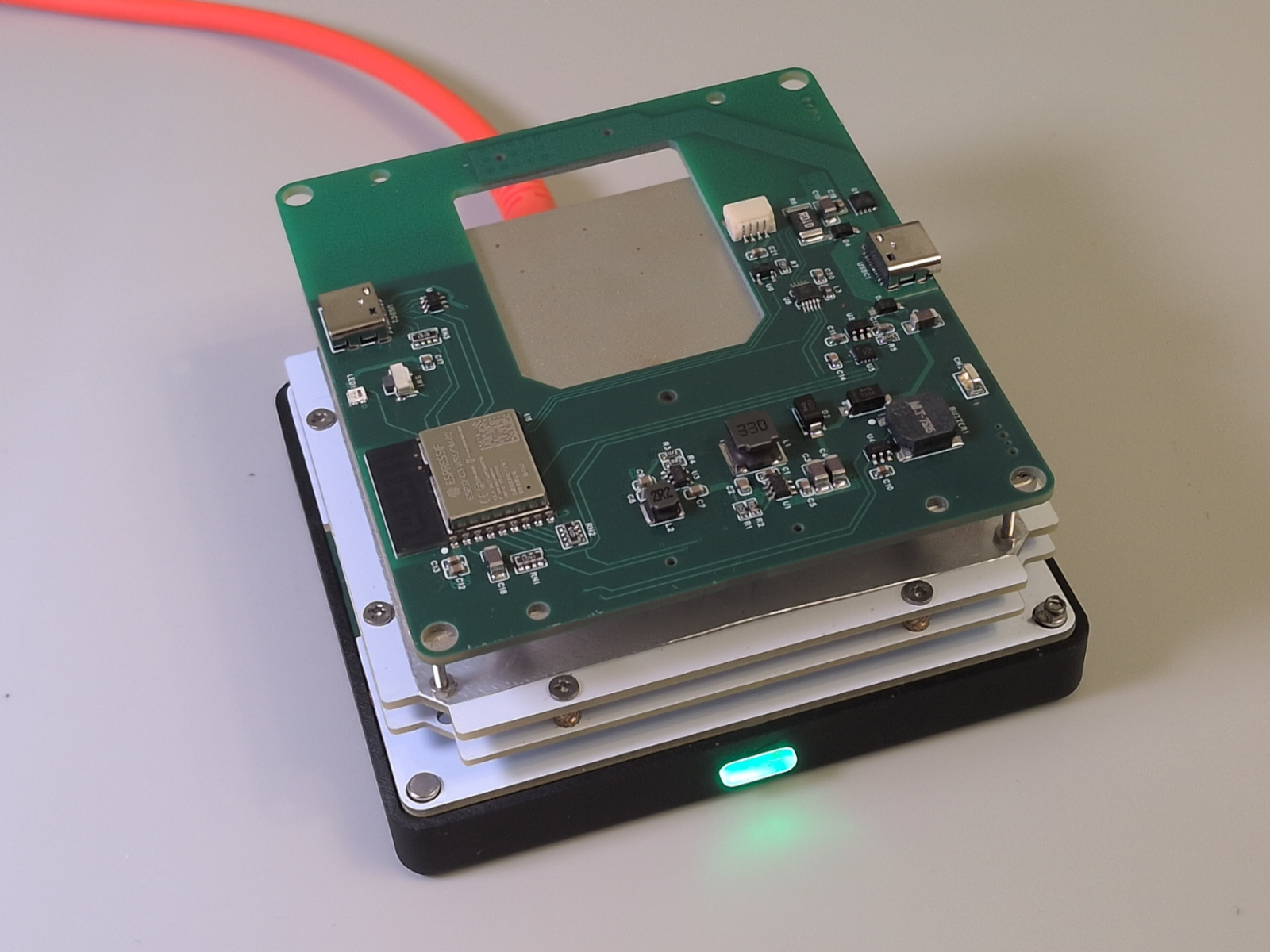

Self-Assembly
As visible in the video, the board overhangs the table edge during the build. It is not good practice. The reason: the goal was to verify that the table can reflow its own main PCB — a self-assembly proof of concept.
