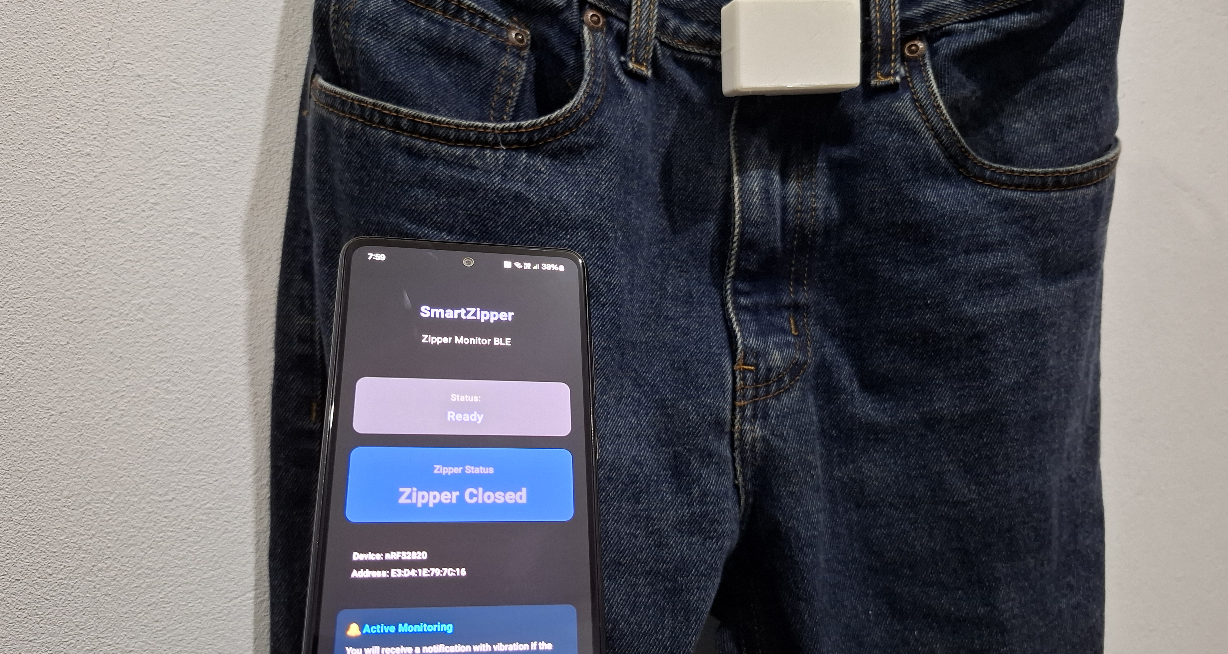

Smart Zipper is a small wearable IoT device that detects the state of a clothing zipper (secured vs unzipped). A tiny magnet on the zipper slider is sensed by a Hall sensor inside the wearable. An nRF52820 sends the zipper state to an Android phone via Bluetooth Low Energy and the app can notify you discreetly if the zipper remains unzipped for too long.
Why this project
This is a simple private solution to avoid an awkward moment. The system is local. It does not use cloud services. It does not collect data.
How it works
  1. A small neodymium magnet is attached to the zipper pull
  2. A TI DRV5032 Hall sensor is placed in the wearable near the zipper path
  3. When the zipper moves the magnet gets closer or farther from the sensor
  4. The sensor output changes and the firmware decides the zipper state
  5. The wearable sends one byte over BLE when the zipper state changes
  6. The Android app shows the status and triggers an alert only when needed
operative_system
Smart Zipper wearable mounted on clothing near the zipper, while the Android app displays the live status (secured / unzipped).

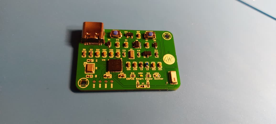

device
PCB assembled

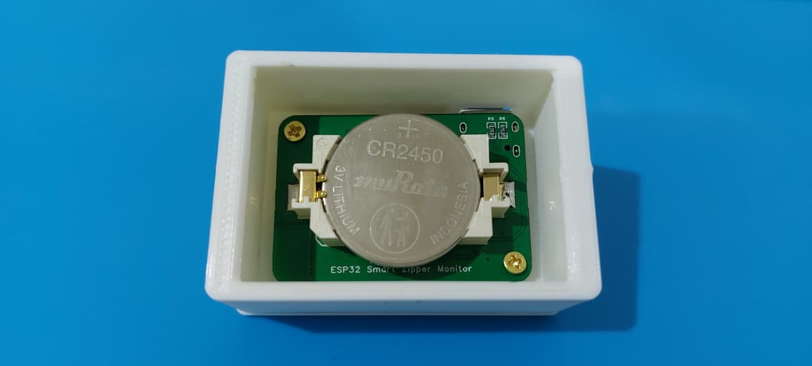

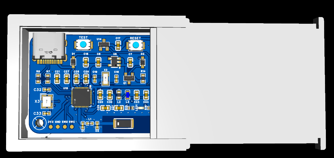

Mechanical case design
The enclosure was created with the EasyEDA 3D Shell tool. It uses a simple push cover style so the PCB can be installed fast and the device stays compact. The design includes two mounting points for M2 screws. The holes are sized to accept heat set inserts, so the cover can be opened and closed many times without wearing the plastic. This keeps assembly simple and makes the case more durable. Images to include and how to describe them Place
3dshell
EasyEDA 3D Shell view of the push cover case designed around the PCB

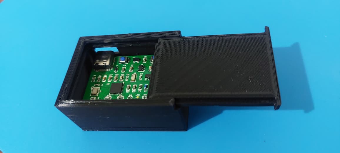

caseprototype
Preliminary printed case prototype showing the real size and fit around the PCB
final_case
Final 3D printed prototype: perfectly aligned with the EasyEDA 3D model.

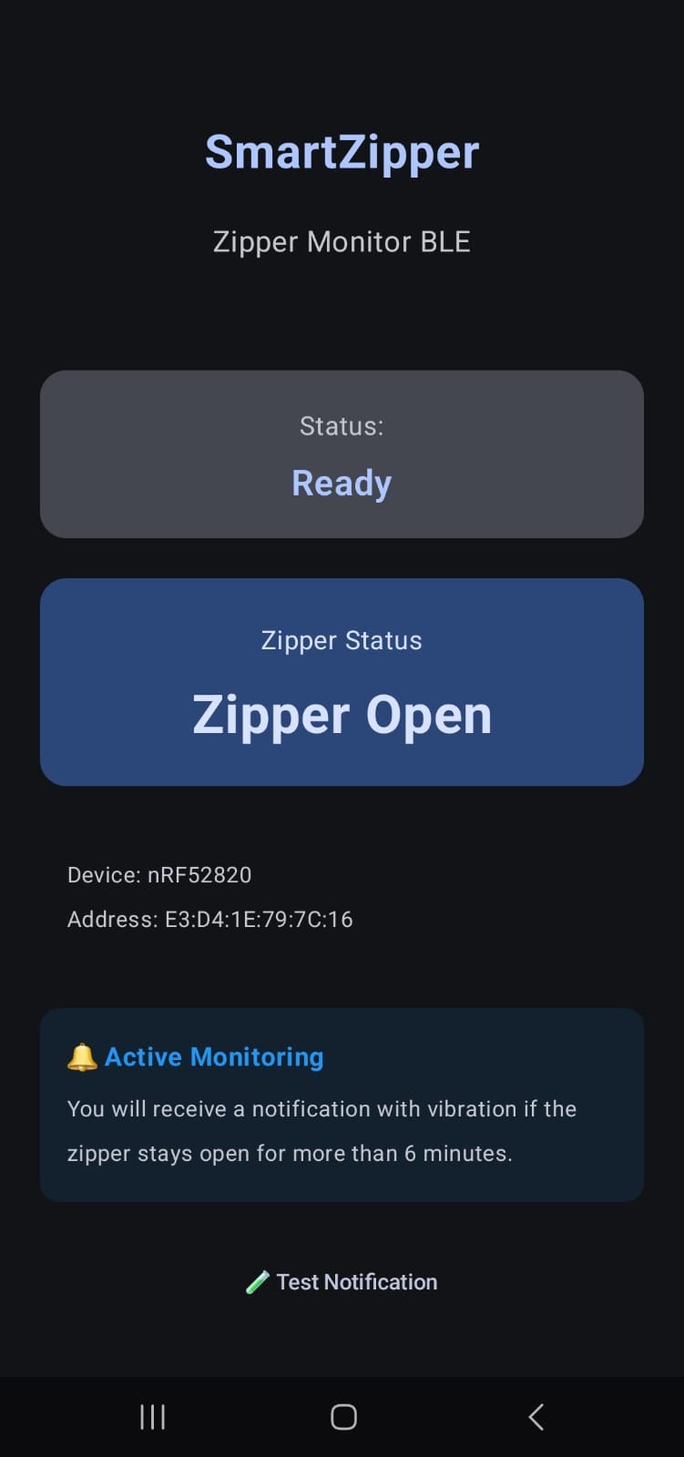

Android app overview
Technology
• Kotlin
• Jetpack Compose
• Bluetooth Low Energy
App structure
BleService.kt
• Keeps the device connected in the background
• Starts a timer when the zipper is open
• Sends the alert notification and vibration
BleManager.kt
• Finds the wearable and connects
• Receives the zipper status from BLE
MainActivity.kt
• Shows the zipper status
• Asks for permissions and starts the service
App interface

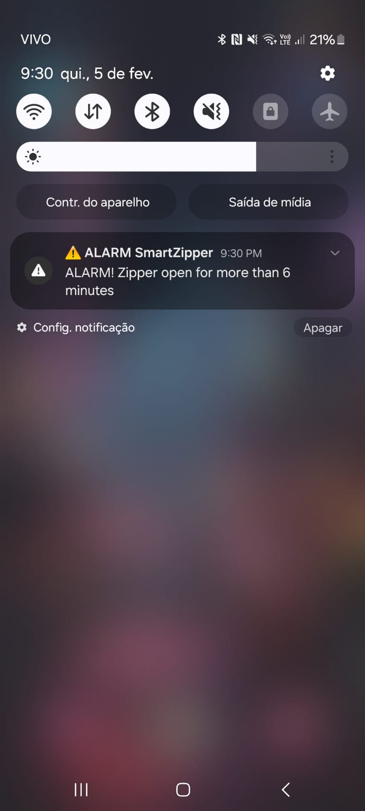

alert
Alert notification
