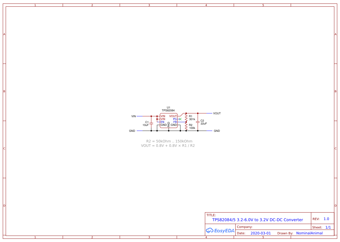

![Rendering of the board](//image.easyeda.com/pullimage/51pAkSunM7K64RGNuVwLfK8ljtIMYRyMC2K2hZib.png) Experimental untested board by a hobbyist! This board is an efficient but cheap 3.2VDC-6.0VDC to 3.2VDC DC-DC converter, based on Texas Instruments TPS82084 (or TPS82085). The output voltage is set by the two-resistor voltage divider: Vout = 0.8V + 0.8V×R1/R2. The board has five components: - 10µF X7R 0805-1206 capacitor, 10V or higher (C1) - 22µF X7R 0805-1206 capacitor, 10V or higher (C2) - 301kOhm 0603 resistor (R1) - 100kOhm 0603 resistor (R2) - Texas Instruments TPS82084 in µSIP-8 package (U1)

1 GND P2,P3 PTH-1-SQUARE 2
2 VIN P1 PTH-1 1
3 VOUT P4 PTH-1 1
4 100k R2 R0603 1
5 301k R1 R0603 1
6 TPS82084 U1 MICROSIP8 1
7 10uF C1 C1206 1
8 22uF C2 C1206 1
