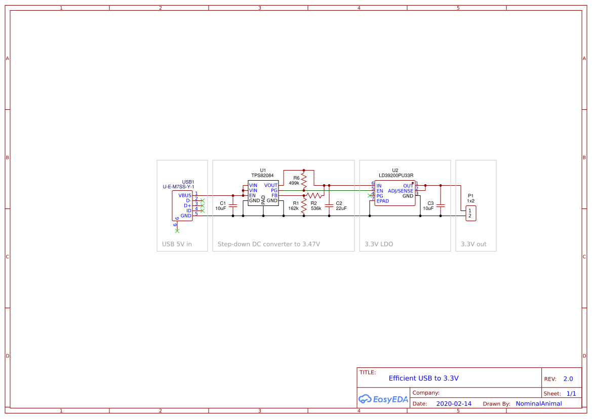

Work in progress - untested circuit created by a hobbyist! This is a highly efficient USB 4.5V-5.7V to 3.3V max. 2A step-down converter, based on [TI TPS82084](https://www.ti.com/product/TPS82084) 8-pin MicroSIP module, with backfeed protection. According to TI Webench Design Report, this should be 90%+ efficient at 1mA - 10mA output, and 93%+ efficient at 10mA - 1850mA output, over the valid input voltage range.
