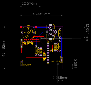

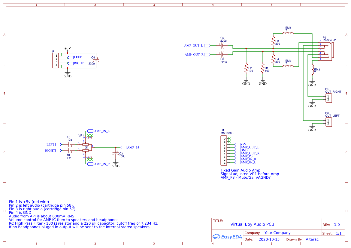

This is a remake of the Nintendo Virtual Boy Audio PCB VUE-AMP-01, it is for OEM replacement, and needs to reuse the amplifier chip.
The Amplifier chip is currently unknown, it is marked MM1030B, and unavailable so you will need to salvage that.
I still have to determine the part number/specs for the 3 EM Filters.
Untested.

PCB
1 /
1 OUT_RIGHT P4 HDR-F-2.54_1X2 1
2 OUT_LEFT P3 HDR-F-2.54_1X2 1
3 10K VR1 RES-SMD_RK14J12R0A0C 1
4 ? EM2,EM1,EM3 L_AXIAL-0.4 3
5 100 R1,R2 R_AXIAL-0.3 2
6 330 R3,R4 R_AXIAL-0.3 2
7 10u C1,C2 CAP-D3.0×F1.5 2
8 100u C3 CAP-D3.0×F1.5 1
9 220u C4,C5,C6 CAP-D3.0×F1.5 3
10 PJ-3340-2 P2 AUDIO-TH_PJ-3340-2 1
11 HDR-F-2.54_1x4 P1 HDR-F-2.54_1X4 1
12 MM1030B U1 HDR-F-2.54_1X9 1
